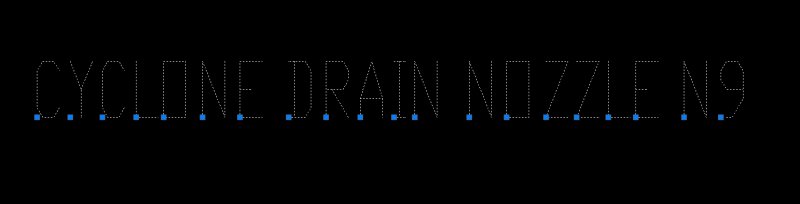

Converting single characters into one word
After converting pdf to dxf, all converted text shown as a single character (as shown on picture). Is there way to convert it back to words and sentences by using lisp?
Could be done just make a "list" of characters and their x insert position the reason for x is that they may not have been created in the order viewed so your list has to reflect a continuous string as viewed, you could then use a distance factor bewteen characters to imply a space as a space does not exist. Sloping text ??
A quick thought for text not perp use the lower left bounding box point compared to insert pt to work out order.
Try this Marek .

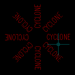

Tank you Tharwat, it work great but only for horizontal and sloped text. If text is vertical: it reverse it. I don't know if it is matter of selection way (I think I try all of it) or something need to be done for code.
There is one sample dwg for testing if you like.
test.dwg
I am sorry for the confusion , and that took a place because I worked on the code for horizontal texts only , so try it now .

Here is my version:

The above should correctly process characters aligned at any rotation.
Using an example from your file:
