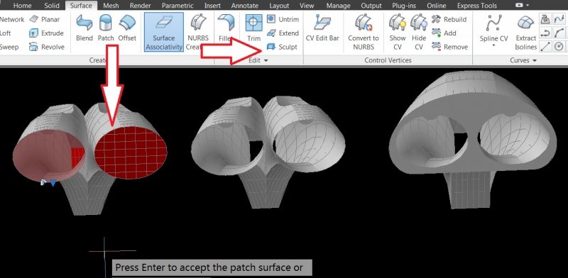

JD Mather Posted October 31, 2012 Posted October 31, 2012 Something like this? Explode, delete, Patch and Sculpt or this http://home.pct.edu/~jmather/content/CAD238/AutoCAD%202007%20Tutorial%207.pdf in later versions there is the surfsculpt command that should make all of this easier. Quote
Jimmy111 Posted October 31, 2012 Author Posted October 31, 2012 Thanks. Ive seen the Autocad 7 tutorial before. My main concern is inside cores. How did you do the top one? Quote

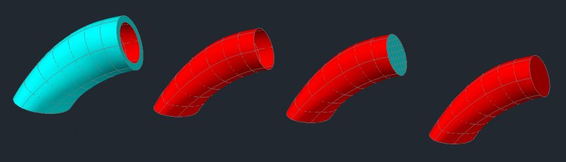

JD Mather Posted October 31, 2012 Posted October 31, 2012 Explode the solid. (copied first) Delete the outer surfaces. Patch the end holes. Sculpt the surfaces to form solid. I tried to attach the actual file (as in the image), but it was too large. Quote

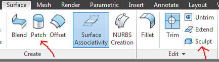

JD Mather Posted October 31, 2012 Posted October 31, 2012 I am not familiar with 2010 - do you see Sculpt as in image above? Do you see Patch as in image above? Quote

JD Mather Posted November 10, 2012 Posted November 10, 2012 For really simple stuff you might use Thicken. But I recommend for this type of work you upgrade to a modern MCAD program like Autodesk Inventor. I hesitate to mention that free Inventor Confusion has Delelet Face and a Sculpt commands. http://labs.autodesk.com Quote

JD Mather Posted November 11, 2012 Posted November 11, 2012 I have Inventor 2010. Its just that most of my work is in Autocad and most of my customers use autocad and things need to be compatible. Inventor reads/writes dwg file. Customer can read the dwg fine from Inventor. See attached Inventor dwg file LT&1 intake1_core.dwg Or in later versions of AutoCAD Patch and Sculpt right to left in the image (same thing I did in Inventor). Quote
