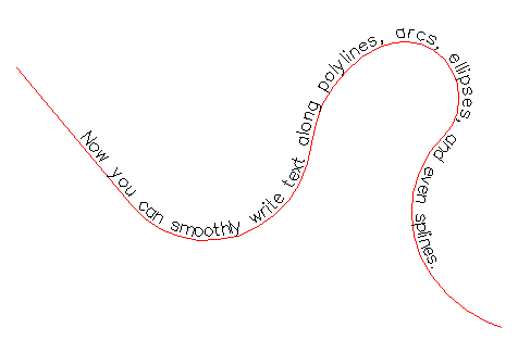

ToolPac includes a utility that will generate text along an ellipse (and/or other linear objects...)
