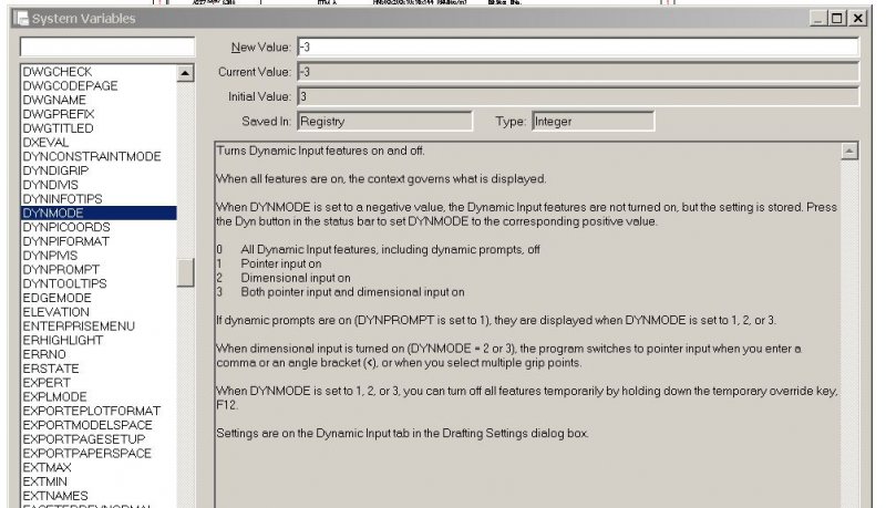

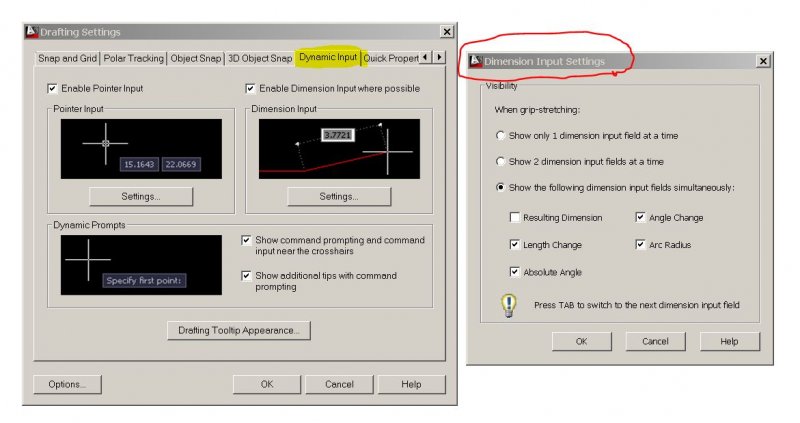

Dadgad Posted November 3, 2012 Posted November 3, 2012 Welcome to the forum. Whenever you want to research the available system variable options, or confirm your current system variable settings use the SYSVDLG command, and you will find an absolute wealth of information, as evidenced by the attached image describing the DYNMODE system variable. Should you not be familiar with the additional DYNAMIC DIMENSIONAL INPUT settings, as shown in the second attachment, there are a number of useful and interesting different ways to go. As Mircea pointed out, you likely have the DYNAMIC INPUT ICON at the bottom of your screen, as circled in red in the other image. If you do not see it, then it must have been disabled in the TOGGLE SELECTION menu in the lower right hand corner of your screen. Quote
