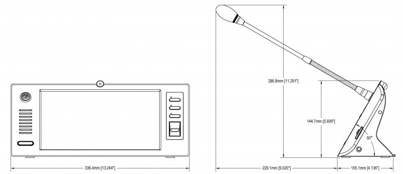

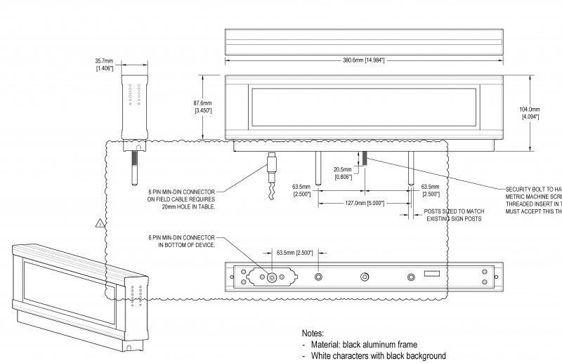

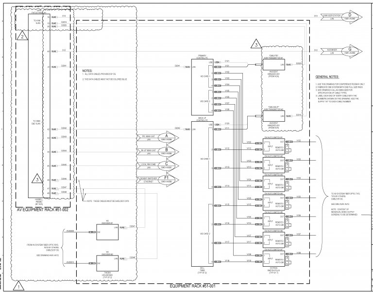

MVa12 Posted November 6, 2012 Posted November 6, 2012 Hello, I am a new member to the site, so first of all thank you for any and all future help. I have enrolled in a 3 day, 24 hr AutoCAD class that is scheduled to start later this month. I have been given access to the online materials, so I've decided to learn on my own until the class begins. First beginner's question: when drafting lines using coordinates, the first coordinate is laid down fine, for example 16, 16... but when I enter the next coordinate, say 16, 32.. the second value is interpreted as an angle, and not a Y-axis point. Any idea one what I am doing wrong? Secondly, a more broad question: I am a product engineer at my company, and I will be creating system diagrams & engineering files such as the ones attached. The first example is a wiring diagram, the other two are typical files created for product reference before installation on-site. Based on these docs, are there any tutorials that somewhat focus on this type of work? Would it behoove me to upgrade to Mechanical/Electric? What is the difference between the two, and which one is more closely-related to my type of work? Thanks again for any help you all may provide me! Quote
