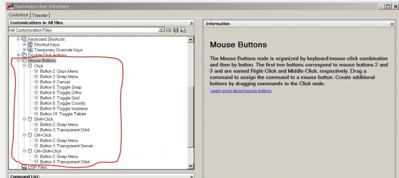

Tiger Posted November 6, 2012 Share Posted November 6, 2012 Hi an welcome to the forum! type CUI to enter the Customize User Interface > In the top left box find Mouse Buttons and expand till you see Shift+Click and Ctrl+Click - there is where you want to substitute Snap Menu for something else. I don't have Alt+Click listed there, I have no idea how to add it either I'm afraid. Quote Link to comment Share on other sites More sharing options...
Dadgad Posted November 6, 2012 Share Posted November 6, 2012 Welcome to the forum. You can set your customized right click preferences very easily in the CUI. I will post an image in a few minutes. Quote Link to comment Share on other sites More sharing options...

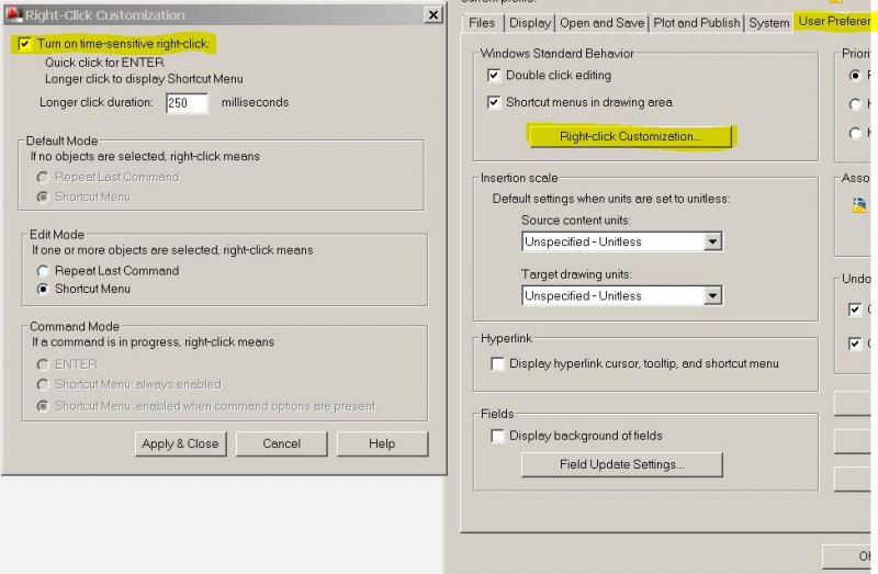

Dadgad Posted November 6, 2012 Share Posted November 6, 2012 If you favor right click options, you might want to try, if you don't already use it, the TIME SENSITIVE right click option. Quote Link to comment Share on other sites More sharing options...
guran Posted November 6, 2012 Author Share Posted November 6, 2012 Thanks everyone for the quick respons! But I still don't understand how make changes to, let's say, the shift+right click menu without affecting the ctrl+right click menu. If you lock in CUI, both have the same name and the same macro. Quote Link to comment Share on other sites More sharing options...
Dadgad Posted November 6, 2012 Share Posted November 6, 2012 Thanks everyone for the quick respons! But I still don't understand how make changes to, let's say, the shift+right click menu without affecting the ctrl+right click menu. If you lock in CUI, both have the same name and the same macro. What you want to do is redefine one of the combinations which you wish to replace, and you will do that in the PROPERTIES window on the right side by defining the NEW MACRO which you wish to be assigned to that combination. Quote Link to comment Share on other sites More sharing options...
