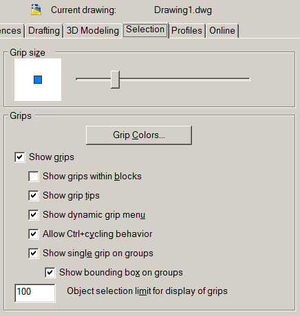

ittayd Posted November 7, 2012 Posted November 7, 2012 Hi, I don't know how, but a drawing I was working on forever stopped having grip points like it used to. More precisely, when I click a line there's only one grip point that can be used only for moving the line, not stretching. I have all selection modes turned on in the selection options thanks, ittay Quote

MSasu Posted November 7, 2012 Posted November 7, 2012 On newer version it can be set also to 2 - this enable midpoint grips on polyline segments. Regarding your issue, please ensure that GRIPSIZE system variable is not set to a very small value. Also, a restart of the editor, or even workstation, may help. Quote
ittayd Posted November 7, 2012 Author Posted November 7, 2012 About gripsize: I can see a grip, but just at one end of the line and just for moving (not stretching). Restart doesn't help. Other drawings behave normally. Quote
edwinprakoso Posted November 7, 2012 Posted November 7, 2012 Check your selection tab in option dialog. Is there anything different with my default setting? Color perhaps? Quote
ittayd Posted November 7, 2012 Author Posted November 7, 2012 It is the same. I also selected the first option, made no change. I do have grip points, but just for moving, not for stretching and only a single one for a line. Quote

ittayd Posted November 7, 2012 Author Posted November 7, 2012 I found the reason: Some lines had a very high 'Start Z' value. This probably caused autocad to refuse to stretch them or something like that Quote
ittayd Posted November 7, 2012 Author Posted November 7, 2012 I found the reason. It seems some lines were way up (Z=1e99). this probably made autocad refuse to stretch them via grip points (although i could do it with the stretch command). making sure all were flat fixed the issue. Btw, what is the best way to make sure all entities are flat? (In my case I selected all lines and set start Z and end Z to 0, but other objects don't have these properties). I tried the trick of displacing everything by 1e99 and then -1e99, but it didn't work. Quote
