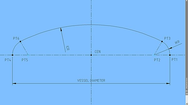

a_differently abled_draft Posted September 18, 2006 Posted September 18, 2006 Hello Everyone, Using AutoCAD 2006 here. i basically deal with Pressure vessels drawings used in EPC or Pharma industries. my questions are; 1. is it possible to write an AutoLisp routine which will ask the user for inpute variables like the shell id, thicknes, length, knuckle radius, angle of toricone, etc,etc & then generate BOTH the elevation & end view (or elevation & plan depending on whether its a horizontal vessel or vertical vessel)for the same? 2.can the AutoLisps gurus here suggest names of Two good books for learning & mastering AutoLisp? (i'm a novice as far AutoLisp is concerned) Any help would be much appreciated. Thanks in advance. Quote

a_differently abled_draft Posted September 22, 2006 Author Posted September 22, 2006 Thanx Adesu, just visited Afralisp site...cool one for an autolisp novice like me. i'm sure to visit it often. i'm gonna try to upload a dwg file of a horizontal vessel here.. not sure how to trim the file size to the recommended 50KB but taking my chances here. What i desire to achieve is, instead of manually drafting the Outline views of the vessel, use a Lisp which will ask for a user input of all reqd. parameters like shell id,length,kuckle radius etc & generate BOTH the elevation & end view ( or plan & elevation) on a fly. still trying to figure this out, cuz it's going to be a Critical productivity enhancement for someone like me who deals primarily with pressure vessels of different kinds. RECEIVER-11 KL.dwg Quote
Adesu Posted September 25, 2006 Posted September 25, 2006 Hi a_differently abled_draft;51407, Your drawing it's enough for detail,and easy to read,but I still not yet understand what is meaning the "175 IKR",I know this for value radius,but for "IKR" what that?,then "1750 ICR". if you see at layer L1 you got line with color yellow,what that?,how long that line it have and what degree to the horizontal line (look at "VIEW FROM "X" "),or it's symbol for weld?. I would attempt to create a lisp for this drawing,I hope you patient to received my code,because this drawing rather complex. Thanx Adesu,just visited Afralisp site...cool one for an autolisp novice like me. i'm sure to visit it often. i'm gonna try to upload a dwg file of a horizontal vessel here.. not sure how to trim the file size to the recommended 50KB but taking my chances here. What i desire to achieve is, instead of manually drafting the Outline views of the vessel, use a Lisp which will ask for a user input of all reqd. parameters like shell id,length,kuckle radius etc & generate BOTH the elevation & end view ( or plan & elevation) on a fly. still trying to figure this out, cuz it's going to be a Critical productivity enhancement for someone like me who deals primarily with pressure vessels of different kinds. Quote
a_differently abled_draft Posted September 25, 2006 Author Posted September 25, 2006 IKR = Internal Knuckle Radius ICR = Internal Crown Radius ( of the dish end) are u referring to the weld lines in end view used to secure gusset ribs to the saddle supports? oh they need not be generated in lisp. by any chance u've messenger id? Quote
LSR Posted September 25, 2006 Posted September 25, 2006 IKR = Internal Knuckle RadiusICR = Internal Crown Radius ( of the dish end) are u referring to the weld lines in end view used to secure gusset ribs to the saddle supports? oh they need not be generated in lisp. by any chance u've messenger id? You can start from this: ; To convert degrees to radians (defun DTR (D) (/ (* pi D) 180.0) );end of DTR (defun C:DISH () ;User Input (setq CEN (getpoint "\nEnter center point of Vessel: ")) (setq DIA (getreal "\nEnter Vessel Diameter (DIA): ")) (setq IKR (getreal "\nEnter Internal Knuckle Radius (IKR): ")) ; To get the points of Knuckle Radius (setq DIA2 (/ DIA 2)) (setq PT1 (polar CEN (DTR 180) DIA2)) (setq PT2 (polar PT1 (DTR 0) IKR)) (setq PT3 (polar PT2 (DTR 120) IKR)) (setq PT4 (polar CEN (DTR 0) DIA2)) (setq PT5 (polar PT4 (DTR 180) IKR)) (setq PT6 (polar PT5 (DTR 60) IKR)) ; To draw the Dish (command "ARC" PT3 "C" PT2 PT1) ; Arc Start/Center/End (command "ARC" PT4 "C" PT5 PT6) ; Arc Start/Center/End (command "ARC" PT6 "E" PT3 "R" DIA) ; Arc Start/End/Radius );end of DISH The drawing should be like this: Study it and You can complete the rest. Good Luck Quote
a_differently abled_draft Posted September 26, 2006 Author Posted September 26, 2006 THANK YOU LSR i'll have to study more & also try this out. & extra thanks for explaining it with a diagram Quote

manikya rao Posted October 18, 2007 Posted October 18, 2007 hi thanks u ur lisp but one mistake u height problem. plz check the height height formala h = 1/4 X id (~) bye You can start from this: ; To convert degrees to radians (defun DTR (D) (/ (* pi D) 180.0) );end of DTR (defun C:DISH () ;User Input (setq CEN (getpoint "\nEnter center point of Vessel: ")) (setq DIA (getreal "\nEnter Vessel Diameter (DIA): ")) (setq IKR (getreal "\nEnter Internal Knuckle Radius (IKR): ")) ; To get the points of Knuckle Radius (setq DIA2 (/ DIA 2)) (setq PT1 (polar CEN (DTR 180) DIA2)) (setq PT2 (polar PT1 (DTR 0) IKR)) (setq PT3 (polar PT2 (DTR 120) IKR)) (setq PT4 (polar CEN (DTR 0) DIA2)) (setq PT5 (polar PT4 (DTR 180) IKR)) (setq PT6 (polar PT5 (DTR 60) IKR)) ; To draw the Dish (command "ARC" PT3 "C" PT2 PT1) ; Arc Start/Center/End (command "ARC" PT4 "C" PT5 PT6) ; Arc Start/Center/End (command "ARC" PT6 "E" PT3 "R" DIA) ; Arc Start/End/Radius );end of DISH The drawing should be like this: [ATTACH]134[/ATTACH] Study it and You can complete the rest. Good Luck Quote
