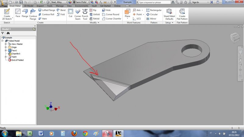

I have to build a simple sheet metal (20 mm thickness) with 17 mm chamfers
and a bend as you can see in the attached example file
The problem is that i have to bend this part and if i apply the fold feature from sheet metal, the bend portion of the part is not bended and protude out of the plate.(see screenshot in the attached)
On the contrary if i switch to std part and make a bend when i come back to sheet metal and flat it out the flat profile has not the correct shape.
What i mean is: does exist a modeling worflow as in real world:part is cutted from sheet metal-chamfered and finally brake press-bended
Every suggestion/comment will be appreciated.

Why do you need to go to sheet metal for flat pattern - you already have it before the Bend feature.
Derive Component the part prior to bending and then Bend Part the derived component.

Thank you for your suggestion (i was not considering the deriving power!!),anyway i guess i could use sheet metal
for the following reasons:
1) when i make the 2d drawing i can place the two views i need simply by checking the flag (flat pattern-folded model) in the dialog box.
2) If sheet metal tools could be used the bending line would be taken in account by inventor and i have no need to dimension
the bend in the drawing.(if the part has several bend lines this is tedious)
3)Finally making a derived component,naming it,and placing the two different views from two files (parent and child) in the 2d drawing takes a little more time
than working with sheet metal tool.

Ok JD, let me clarify:
The part i have posted has only one bend and you can consider it as a simple example.
Our company manufacture booms for digging and demolition hydraulic excavators by welding several plates (15-20 different parts)
These plates have slighty different shapes with chamfers and (sometimes) more than one bend ; sheet metal template normally is the right tool for me but i find that it does not work properly with bended chamfers.
So please consider my initial question as a general one not to be applied only to the specific posted part.
