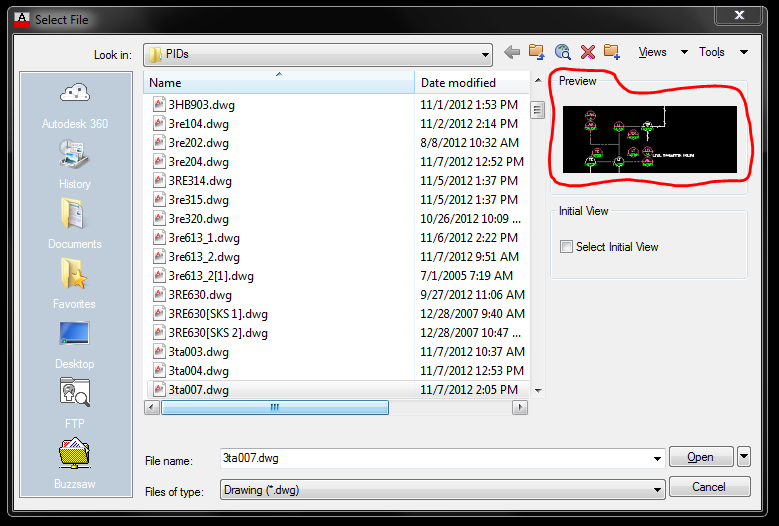

Taylor Gibson Posted November 8, 2012 Author Posted November 8, 2012 I'm sorry I was being ironic. They've icreased the resolution of the thumbnail, but it's of no use whatsoever because you can't actually see the detail unless you go through the rigmarole of changing the background colour! One could hardly call this an improvement. Quote
ReMark Posted November 8, 2012 Posted November 8, 2012 Just so we are all clear on what is being talked about. Have I circled the preview of which you are speaking? Quote
Taylor Gibson Posted November 8, 2012 Author Posted November 8, 2012 Yes ReMark, If that thumbnail was zoomed out to an A1 dwg, for example, it becomes unreadable. Quote
ReMark Posted November 8, 2012 Posted November 8, 2012 I agree with you but it is only a thumbnail. I'm legally blind in one eye and have been doing CAD a number of years yet I can still recognize the drawing that is pictured in a thumbnail well enough to know if it is the one I want or not. Are you saying that in some version of AutoCAD prior to 2013 thumbnails were clearer? If so, which version of AutoCAD? I have 2012, 2010, 2007 and 2004 all loaded as well as 2013. Quote

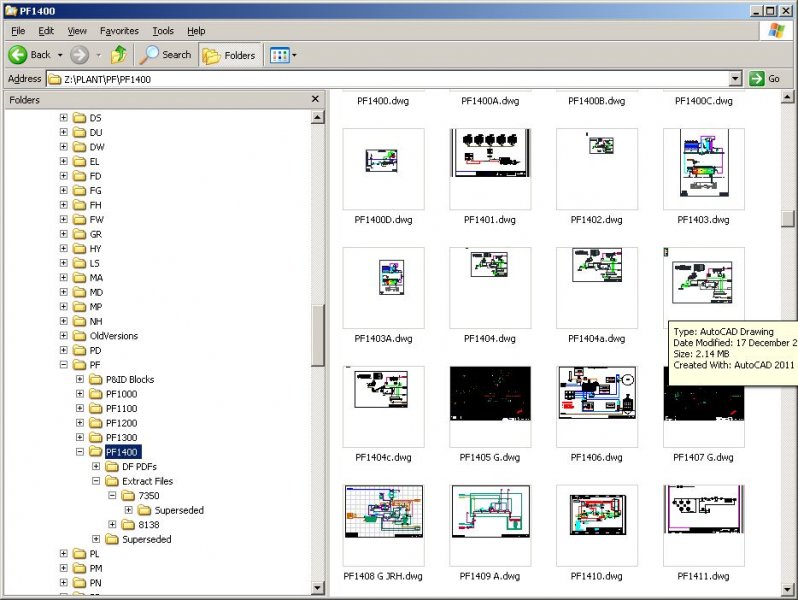

Taylor Gibson Posted November 8, 2012 Author Posted November 8, 2012 Yes. The ones with the white background, they are 2010, the black blobs are 2013. I know the scale is a bit small but you get the idea. Quote
SLW210 Posted November 8, 2012 Posted November 8, 2012 Appears to be more a poor layer color for a black background. If the lines were lighter, they would not be as distinct in the white background either, nothing specific to 2013 AFAIK. I deleted your other post. Quote
ReMark Posted November 8, 2012 Posted November 8, 2012 The image shown in post #9 doesn't really have anything to do with AutoCAD per se. You are viewing your files using icons. You are limited to small, medium, large and extra large icons. If there is a setting to be tweaked it would have to be in the Windows Registry. At least that is the way I see it. Feel free to disagree. Personally I don't rely on looking at icons when I want to know what the contents of a folder are when using Windows Explorer. I much rather see the 'Details' (file name, date, size, etc.). Personally choice. Update Just as I suspected, it is a Registry setting that controls thumbnail resolution. One has to create a new DWORD value called Thumbnailsize. Value data is hexadecimal based. Not sure you'll achieve your desired end result though. Still interested? Quote
Taylor Gibson Posted November 8, 2012 Author Posted November 8, 2012 Most of the colours are standard, red, green, cyan, magenta etc. The others are lighter versions of other colours. The criss-cross pattern on the bottom left dwg is in colour 254 (almost white) but clearly visible, both black blobs contain the same criss-cross pattern. I'm sorry about the double posting, I'm wasn't aware I had done it. I did open the thread from the first email reply with the original still open. Quote
Taylor Gibson Posted November 8, 2012 Author Posted November 8, 2012 Although the preview in "open file" is a little clearer it only shows one dwg at once. The file names here contain very little information - just the dwg no. & issue, not my choice I'm just a minnion, so it's quite handy to look at a whole page of thumbnails & try to recognise the dwg one is searching for. Not very efficient I know but he who pays the piper calls the tune. I would be interested in increasing the resolution of the thumbnails, although I may not have the admin rights to do that. They don't like numpties like me messing about with settings! I think i'll end up saving everything with a white background. Quote
