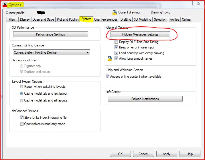

Questions folks. Sorry if it is an ignorant one, but I can't seem to figure this one out myself.
I was opening files and autocad was telling me that some xrefs were missing from the drawing, did I want to locate the xrefs or ignore (I hit ignore and accidentally checked the always do this to these types of files). Now, when I load a drawing I can not get the building to load into the drawings.
Can anyone tell me how to turn the locate feature back on for xrefs? Thanks for any help.

Rasa, it does show the files that are missing. However it is a file that someone sent to me and the file that's missing says it can't be found. Does this mean that i can't properly view the drawing. I tried to attach the dwg. that is of that area however it does not attach it correctly. I am wondering how to turn the auto-locate feature on that I turned off when I told CAD to ignore the xrefs when opening the files.

I am not sure if this will bring back the dialog box about missing xref but try typing XREFNOTIFY and see what value it is. Is it (0)? If so, change it to (2).That may bring it back.

You will need to go into the OPTIONS and open the HIDDEN MESSAGES SETTINGS, to turn them back on.
This screenshot is from Autocad Vanilla, not LT, but I suspect it will be quite similar in LT.
