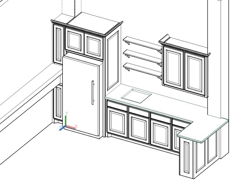

woodworks Posted November 9, 2012 Posted November 9, 2012 Don't think this is a dimassociate problem because dimensions of model are fine in paper space. So I save drawing, even tried regen, then export to pdf for customer, and most of the pdf dimensions are jumbled and in paper space scale. Dimenions are not annotative. I have attached before and after. Anyone have an idea what is happening? Quote
ReMark Posted November 9, 2012 Posted November 9, 2012 Maybe you weren't in paper space when you plotted? Quote
woodworks Posted November 9, 2012 Author Posted November 9, 2012 Yes I have paper space layouts that i usually dimension in. I even closed drawing after saving and when reopened dimensions had changed. Quote
SLW210 Posted November 9, 2012 Posted November 9, 2012 Be nice to see the .dwg file. Sounds like a dimstyle override or a conflict with a dimstyle. Just a guess. Quote
woodworks Posted November 9, 2012 Author Posted November 9, 2012 I was able to delete enough of drawing to resize and upload. Dimensions had same problem when exporting to pdf from layout. My luck it won't happen when you try it. Thanks in advance. Trial.dwg Quote

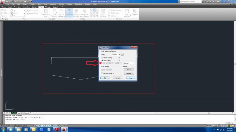

tomhamlet Posted November 9, 2012 Posted November 9, 2012 when i opened your file, the viewport is only on paper space and so are the dimensions. put your dimensions in model space. then, still in model space, make a viewport and click the option "automatic view creation in.." and choose the paper space viewport. Quote
woodworks Posted November 9, 2012 Author Posted November 9, 2012 I have always preferred to dimension model in paperspace. As you suggested I made a viewport from model space but didn't see the option "automatic view creation in" Quote
tomhamlet Posted November 9, 2012 Posted November 9, 2012 you should get this box. if not try double-clicking the viewport in model space. also make sure the current one in your paper space is deleted Quote

SLW210 Posted November 12, 2012 Posted November 12, 2012 you should get this box. if not try double-clicking the viewport in model space. also make sure the current one in your paper space is deleted That is only available in mechanical, not vanilla AutoCAD. Quote
tomhamlet Posted November 12, 2012 Posted November 12, 2012 That is only available in mechanical, not vanilla AutoCAD. was not aware of this. Thanks for the clarification! Quote
