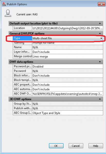

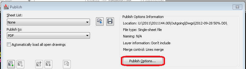

It is possible with AutoCAD's built in PDF plotter.
The OP is using 2009, not sure if that was available on that version. If my memory serves me correctly, 2008 did not have that option.
