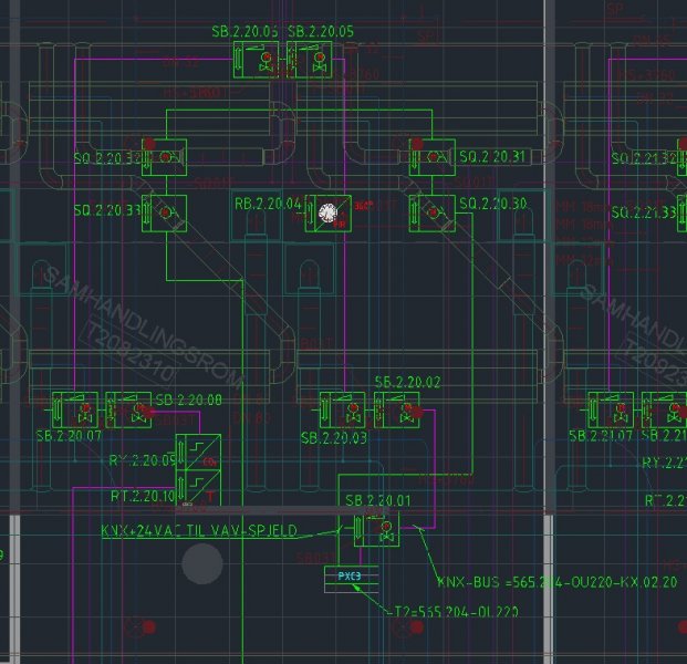

I'm working on a big project. I have about 5600 units whit unique numbering/labels.
Examples of labels:
SQ.2.20.32
RB.2.20.04
When a add a new unit, I have to manually increase the numbering of following units by +1.
Is there possible for me to make a button with a function that does this automaticly?
Example:
I press a label that say "SQ.2.20.32" and it changes to "SQ.2.20.33"
I press a label that say "RB.2.20.04" and it changes to "RB.2.20.05"
This would save me hours of boring work so I would really appreciate it if anyone could help me:)
I use a diesel macro that works from 0, but I think you would need lisp to manage such a complex numbering system.
*^C^Ctext;_m;\;;$M=$(getvar,USERI1);setvar;USERI1;$(+,1,$(getvar,USERI1))

I would not mix diesel inside a lisp rather do everything as a lisp proceedure, using ENTSEL you can pick an object and check if its text so then do next step.
(setq en1 (car (entsel "\nSelect first text number:" )))
(setq el1 (entget en1))
(if (= (cdr (assoc 0 el1)) "TEXT")
 (setq ans (cdr (assoc 1 el1)))
 (setq number ( - (strlen ans) 1))
 (princ (substr ans number 2))
