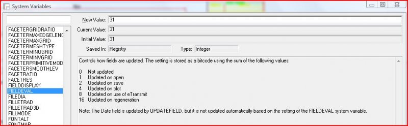

Dadgad Posted November 12, 2012 Posted November 12, 2012 Certainly sounds like the answer will be yes, but have you checked your FIELDEVAL variable setting? Quote
Rooster Posted November 12, 2012 Author Posted November 12, 2012 Thanks for the suggestion - it' set to 31. Quote
