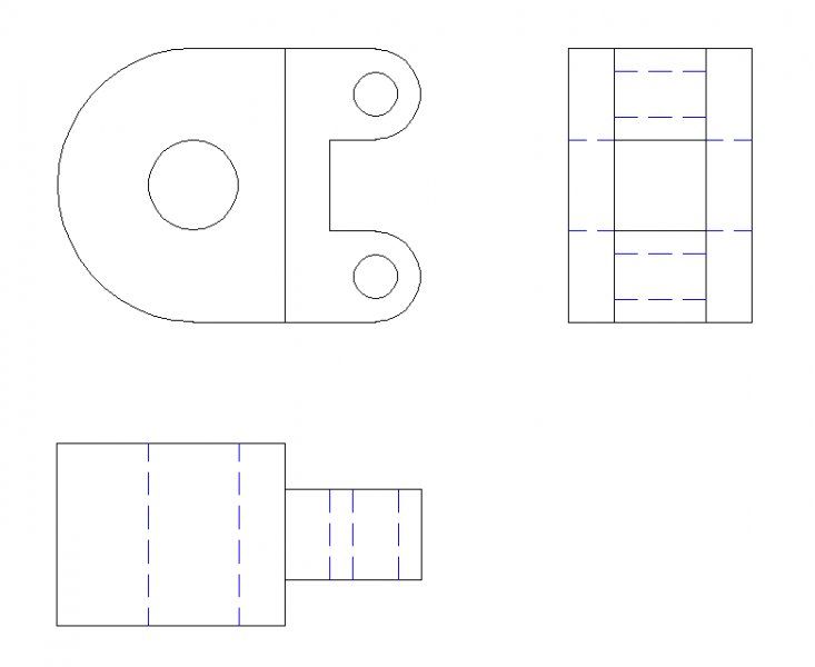

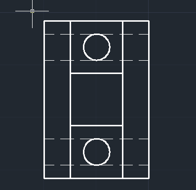

sean214 Posted November 13, 2012 Posted November 13, 2012 I need to someone to check if all my three views are correct. I attached the dwg How do I annotate the views? Thanks in advance isometric drawing ex2.dwg Quote
iainlines Posted November 13, 2012 Posted November 13, 2012 On the right hand view there are two holes that don't appear on the isometric viewAssuming this is third angle projection Quote

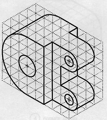

JD Mather Posted November 13, 2012 Posted November 13, 2012 You posted orthographic views, not isometric view. Isometric is the image on graph divisions that you started with. Your views are almost all wrong, particularly the right side view has extra circles that who knows where those came from and the top view is a different depth front to back than in the right side view. You have object lines where you should have center lines. Quote
iainlines Posted November 13, 2012 Posted November 13, 2012 The hidden detail lines for the large hole are missing but otherwise it looks right. I am only looking at the snapshot, not the drawing file Quote

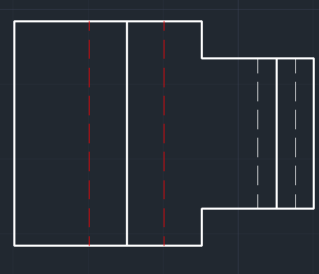

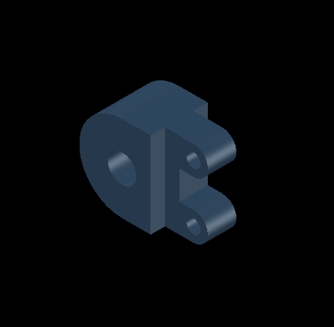

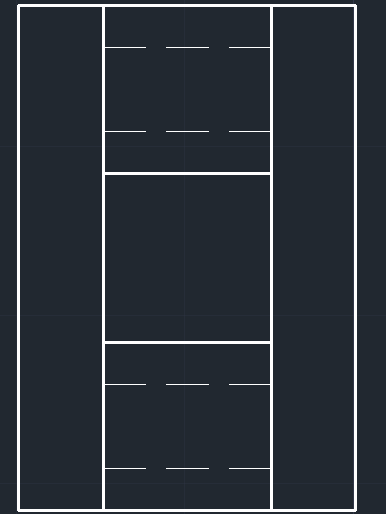

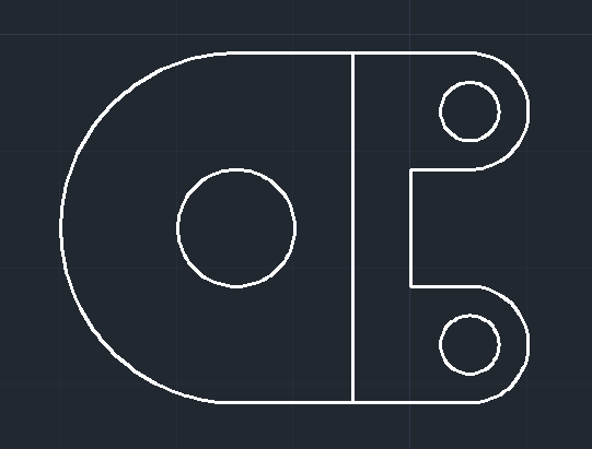

ReMark Posted November 13, 2012 Posted November 13, 2012 AutoCAD 2012 I see. Good. Construct the object in 3D then use the Base View command (Annotate tab > Drawing Views panel) to create the three views. Just a quick mock up. No real dimensions used in the creation. Reproduce at your own risk. Quote
Patrick Hughes Posted November 13, 2012 Posted November 13, 2012 AutoCAD 2012 I see. Good. Construct the object in 3D then use the Base View command (Annotate tab > Drawing Views panel) to create the three views. Just a quick mock up. No real dimensions used in the creation. Reproduce at your own risk. Normally I would agree with you on using Base View (or is it Viewbase?) in a production environtment. In this case I'm guessing it is an exercise and the more important lesson is learning the basics of orthographic projection. Maybe the use of viewbase for self checking after creating the views? Quote
JD Mather Posted November 13, 2012 Posted November 13, 2012 .... In this case I'm guessing it is an exercise and the more important lesson is learning the basics of orthographic projection. Maybe the use of viewbase for self checking after creating the views? I am still required to teach old-school orthgraphic projection like the assignment in this thread. Funny thing is though - I always solve as 2d generated from 3d to generate my key before I ever walking into the classroom to demonstrate the old-school technique. Quote
Patrick Hughes Posted November 13, 2012 Posted November 13, 2012 I am still required to teach old-school orthgraphic projection like the assignment in this thread. Funny thing is though - I always solve as 2d generated from 3d to generate my key before I ever walking into the classroom to demonstrate the old-school technique. That's perfectly understandable J.D. you know what you're doing and need to get things done in a timely fashion. Your students on the other hand must learn what an orthographic view is and how to produce one. Remember the old board method of projecting lines from a 45 degree line? Quote
