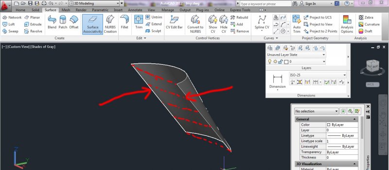

Converting an open shell into a closed solid.
Hello everyone. I want to convert an open shell as shown in picture 1st to a closed solid as shown in picture 2. I want to subtract something later from it so it needs to be solid.
I have searched on this forum and others , and have not found the solution that I'm looking for.
Patch and Sculpt
from your second image it looks like you already have the patch so all you need to do is Sculpt.
Thank you JD Mather and ReMark. Its done. Thanks for your time.
