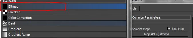

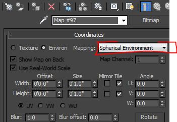

Raudel Solis Posted November 22, 2012 Posted November 22, 2012 if they are real .hdr images there should be no problems clicking on the environment map and setting an HDR image with a bitmap material type. then drag the material from the environment map slot to a material editor slot and make sure it is set to spherical environment, YOU MIGHT NOT HAVE THE CORRECT HDR IMAGE TYPE, YOU MIGHT HAVE A REFLECTION MAP "CIRCULAR" . Furtheremore the rest is all exposure, to help you in the viewport click this to show in viewport Quote
