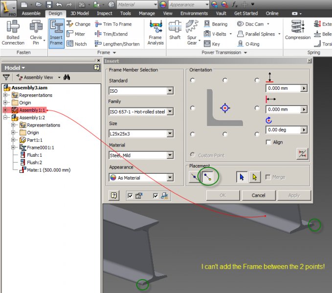

I wanted to show you what i did but now I have an other problem :unsure: I can not add a Frame between 2 points as you can see in the picture:
This morning it was OK i could insert a Frame between the 2 points but this Frame was Grounded i couldn't move it or use Constrain, can you tell me how to ungrounded it.
It doesn't make sense to unground a frame.
You place the skeleton file in the assembly.
You create the frame.
If you need to move a member - you edit the skeleton file.
If this frame moves relative to other parts you place this frame into another assembly as a subassembly.
I am completely confused about why you would unground a frame.
As you said it's beter to edit the skeleton, that's what I do most of time, i'll keep working with this method.
