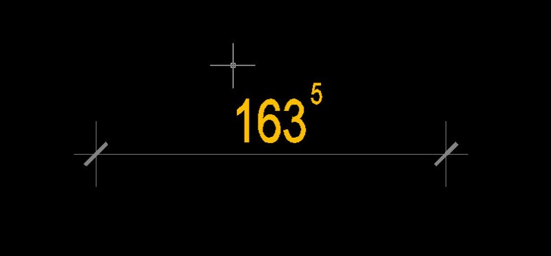

Is it possible to define a dimesnion style that will look something like in the picture attched?
Value is 163cm and 5 mm.

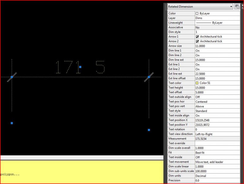

hi
Highlight dim and in proporties Text Override enter \S 5
you dont need the space between the S and 5 but it looks more like what you are after.
I hope this helps

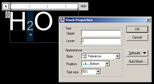

There is an other method, you explode the dimension and use STACK, and you have some Properties as you can see in this image:

you can use it to type chemical symbols:

No need to EXPLODE the dimension. Use the ED command (Short command alias for DDEDIT) and add the stacked character to the end of the dimension text. This way the dimension is not tampered with and is still a usable object.
