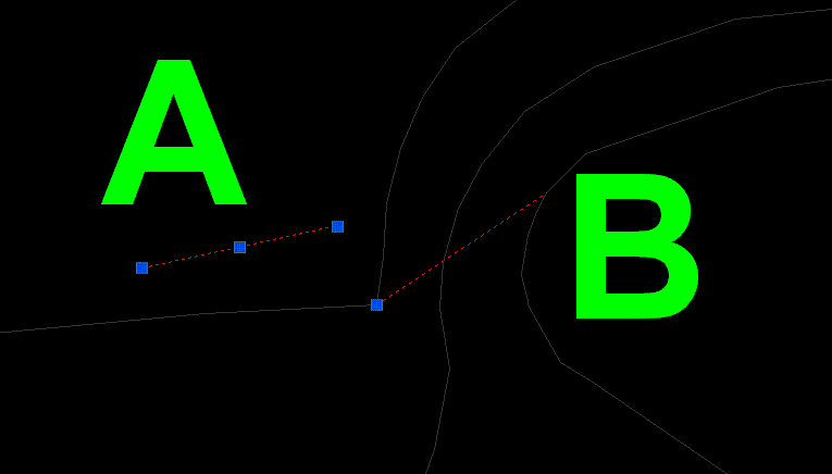

PeteUK Posted November 10, 2008 Posted November 10, 2008 Normally when drawing a basic line and then select it, it has three grips - one at each endpoint and one on the midpoint. However whilst drawing ontop of an ordinance survey layout when I draw a line, it only has one grip at one of the end points instead of the three as above. Is this a setting I can turn off? I've also copied an area into a new drawing but still only get one grip. Another interesting thing is if I draw a line next to the existing lines, it has three grips, but the moment I snap to an existing line it suddenly changes to one grip... Help! Quote
hotrodz0321 Posted November 10, 2008 Posted November 10, 2008 can you post a screen shot of it? Quote
PeteUK Posted November 10, 2008 Author Posted November 10, 2008 The line beside A has just been drawn free. The line beside B has been snapped to two endpoints of the ordinance survey drawing and suddenly lost two of the grips. Quote
eldon Posted November 10, 2008 Posted November 10, 2008 Ordnance Survey use polylines a lot, which does away with a middle grip in a line. Why don't you do a list on that line and see what it is? Quote
hotrodz0321 Posted November 10, 2008 Posted November 10, 2008 type LIST and select that line....are any of the coordinates really far from 0,0? i'd be willing to bet that you are working really far from 0,0......if you moved closer to 0,0 i think the problem would solve itself Quote

hotrodz0321 Posted November 10, 2008 Posted November 10, 2008 Normally when drawing a basic line and then select it, it has three grips - one at each endpoint and one on the midpoint. However whilst drawing ontop of an ordinance survey layout when I draw a line, it only has one grip at one of the end points instead of the three as above. Is this a setting I can turn off? I've also copied an area into a new drawing but still only get one grip. Another interesting thing is if I draw a line next to the existing lines, it has three grips, but the moment I snap to an existing line it suddenly changes to one grip... Help! PeteUK, any solution yet? if so post it so I dont lose sleep tonight because I couldnt figure something out. In all my digging, I've only found this problem to be associated with being a great distance from origin Quote

PeteUK Posted November 11, 2008 Author Posted November 11, 2008 Thanks for the help. Having read through this and the linked post, I think its possibly down to the fact that I am 891798183.4mm away from 0,0! Reason being because I am working on several OS plans and to select certain co-ordinates, I have to run the drawing from an OS grid. However until now I've not had this problem, other parts of the drawing have always had three grips per line... On a seperate note, would the OS UK grid differ from the World Wide OS grid? As my origin point at 0,0 doesn't look like it would be to the south west of the Isles of Scilly as mentioned above. More like it would be at the most south west point of the UK. EDIT : Just read eldon's post properly. Anyone know why the 0,0 point is set where it is? Quote
eldon Posted November 11, 2008 Posted November 11, 2008 First of all, what result did you have from Listing the object. Secondly, on a historical note, Ordnance Survey is the mapping of the UK only. The rest of the world have to put up with the UTM zones, unless they have their own local sytem. The zero point was set there because then all Eastings and all Northings would be positive One way that you could work nearer to the (0,0) point would be to work in metre units, then all your coordinates are divided by one thousand. Quote
PeteUK Posted November 11, 2008 Author Posted November 11, 2008 The line lists like any other line - nothing out the ordinary. Thanks for that eldon - I'd have thought they would have kept Ireland within that theory though, potential 'expansion' and all that! Quote
