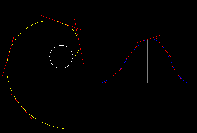

I am drawing a gear and now i need to connect points to draw involute for a gear tooth:
http://i46.tinypic.com/1o6fls.png
Points are numbered. I'm trying to draw with a spline, but i don't know where to put last point of a spline to draw an exact involute - like for example - if i would draw like this and press enter - i would get this spline:
http://i46.tinypic.com/546ttv.png
But if i would move cursor in a different direction and then press enter - i would still get almost identical spline, but still, not the same:
http://i48.tinypic.com/2le1c3m.png
So how do i draw an accurate involute? Maybe i should draw one more point and then stop drawing spline?

If you got the points from a formula, then yes, you can calculate more points at the top to increase the precision.
About the spline curves: if you move a point, the curve will get a different shape. The more far from the changed point, the more smaller the change. Theoretically, the whole curve will change but using enough points, the amount of change can be small enough.
My advice: use an additional point at the top to end the curve, and one more point (calculated with the same formula, of course) as tangent direction.

Well, i'm doing involute by the book - it's kinda mix of formula and graphical approach, so i just calculated couple more points and got that spline. Sadly enough, something went wrong and my gears..don't fit.
Another minor question - how can i draw tangent line to some point on the spline? Like that:
http://i47.tinypic.com/33lo5xc.png
I've read here that you can do this with offsetting - but that's not accurate enough, because from a graph i'll need to calculate some unknowns. Onsnapping not actually works too.

I know how to do it in the circle, but the thing is - i need to do it on a spline. I have graph like this:
http://i45.tinypic.com/1zgu5q0.png
Its points, connected with a spline. Now i need for each point to have it's tangent:
http://i50.tinypic.com/104i5nt.png
And with snaps results are like this(i've chose tangent with right shift, and then pressed on a point):
http://i49.tinypic.com/dd0nm.png
So maybe i'm not using snaps correctly, or maybe someone has an idea how to do it?

Lurking,
this will draw a spline (I hope is the correct profile for gear)

And this will draw tangent line to a curve

You may want to adjust these functions to suit your needs.
First one is drawing a complete curve, as it travel thru entire circle. Obviously, you don't need it that way.
The second will draw a line which has length equal 20% of selected curve, but it can be adjusted.
