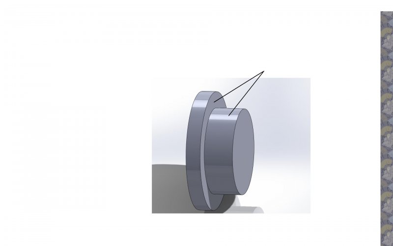

Ribs on Cylindrical parts
How to create ribs on a cylindrical part as shown using solid works (Between the marked)??? :)

Start new sketch on plane going through center of part.
Sketch diagonal line for rib.
Use the Rib feature tool.
Circular pattern if needed.
