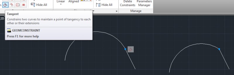

Don't forget about geometric constraints.
All this time I suspected there were tools I should have been using to do things like this. Apparently there aren't.
Geometry Constraints (but they are kind of clunky in use in AutoCAD, fairly transparent in use in next-generation tools).
Mike beat me to it - but he didn't add pretty pictures....
