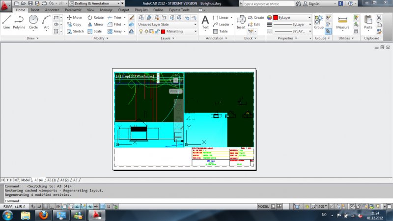

sheherezade Posted December 1, 2012 Posted December 1, 2012 I've completed my drawing in modelspace, scale 1:1. I'm about to set up for plotting in 1:00 scale. I go to layout, pan the image, set scale to 1:100 and lock the viewport. Everything is peachy so far. I also need to have some dims on my drawing, so I go back to paperspace, change the scale from 1:1 to 1:100 and all hell breaks loose and my drawing is left as a mess. Would anyone mind having a look at my file and if possible give me some input as to what's going on and hopefully how I can work around this? kopi.dwg Quote

sheherezade Posted December 1, 2012 Author Posted December 1, 2012 Well, here's an example of the mess I was talking about. What I've done prior to this "incident" is make 3 copies of the A3 layout already in the drawing file, gone into the first of these A3 layouts, deleted the existing viewport and drawn two vertical viewports instead. I then panned the first of my two floorplans into the first viewport, changed the scale to 1:100 and ended up with this... It's not visible on the screendump, but when this happens the command line comes up with "Could not evaluate hatch boundaries at all supported scales" and "Hatch boundary associativity removed - no more scales may be added." Quote
rkent Posted December 2, 2012 Posted December 2, 2012 You don't want blocks like windows to be annotative, they should always view the same size regardless of the annoscale. The mess you are seeing is the windows and other annotative blocks adjusting to the new annotative scale. Quote

sheherezade Posted December 2, 2012 Author Posted December 2, 2012 (edited) Sorry, I mean modelspace. Anyway, I think I figured it out at last. I ended up exploding all the blocks and redefining them without the annotative option. Might not be the easiest way, but it seems to work. That was a time consuming lesson learned. Thank you to all who pitched in. Edited December 2, 2012 by sheherezade Quote
ReMark Posted December 2, 2012 Posted December 2, 2012 You could have far more easily opened the annotative block using the BEDIT command then open Properties and where it says Annotative changed it to 'No'. It's in the Block section of Properties. Save and close. Done. Quote
