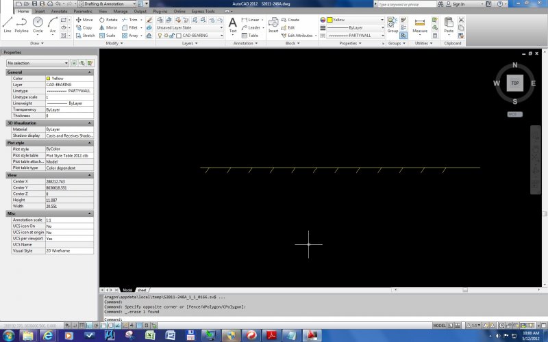

Arty Posted December 5, 2012 Posted December 5, 2012 Hi, I have just made a new linetype but the ends look funny...I can't see why the ends, before and after the slash are different lengths? Anyone who knows how to make them more even? Arty Quote
MSasu Posted December 5, 2012 Posted December 5, 2012 Please post the definition of the troublemaker linetype to allow us to help you debug it; will be also useful to post what value did you used for LTSCALE system variable. Quote
Arty Posted December 5, 2012 Author Posted December 5, 2012 (edited) hi, here's the code *PARTYWALL, Party wall /_/_/_/_/_/_/_/_/_/_/_/_/_/ A,0.1,["/",STANDARD,S=.05,R=0.0,X=-0.1,Y=-.05],0.1 Not sure what LTSCALE system variable is... I tried this line in a drawing which is A1 1:750 if that's to any help... Thaks for trying to help! Edited December 5, 2012 by SLW210 Added Code Tags! Quote
MSasu Posted December 5, 2012 Posted December 5, 2012 A system variable is a kind of switch for drawing's environment - just write it down on command prompt, press and check what it return. Quote
MSasu Posted December 5, 2012 Posted December 5, 2012 Please check if this adjusted version allows for better balanced ends: *PARTYWALL, Party wall /_/_/_/_/_/_/_/_/_/_/_/_/_/ A,.01,.1,["/",STANDARD,S=.05,R=0.0,X=0,Y=-.05],.1 Quote

Arty Posted December 6, 2012 Author Posted December 6, 2012 Thanks MSasu, It look much better! /Arty Quote
