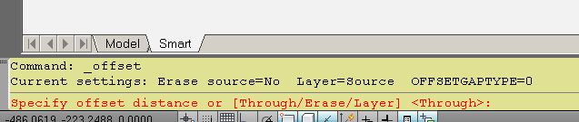

Dadgad Posted January 25, 2013 Posted January 25, 2013 Here is what I get using Autocad 2012 Vanilla. Quote
dbroada Posted January 25, 2013 Posted January 25, 2013 UBRIGNS: I am using AUTOCADLT 2000 and when I click on the offset icon it will ask me (on the command line) SPECIFY OFFSET DISTANCE or [THROUGH] and I can enter any number I want. Was wondering when they took this feature out of the program ? welldriller I don't think they have (as confirmed by Dadgad and indeed a look at my command line too) but I think the OP was offsetting by different amounts. If you want one pline offset by 2.67, then by 3.74 then by 12.116 (etc.) you have to exit the command to keep changing the distance. Either that or do all your construction before hand. Quote
