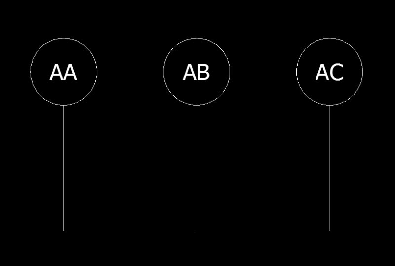

ashnav_msit Posted December 6, 2012 Posted December 6, 2012 Hi Friends, I have a question. Now i am working on setting up the grid system for drawings . My task is after setting the grid label the possition of equipments od Data Center( e.g ups, panels) on drawing. I am able to set the grid but i don't know how to get my grid coordinate identifiers(x coordinates and y coordinates) which will help me to label the equipments. Quote

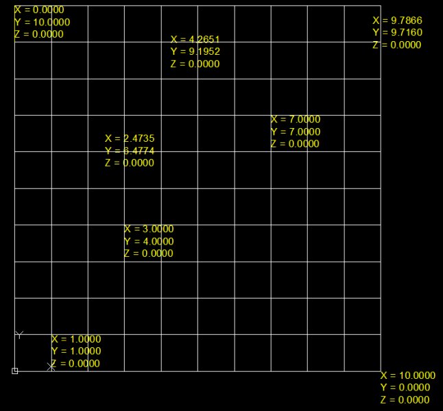

ReMark Posted December 6, 2012 Posted December 6, 2012 Can you attach an image of one of your drawings so we know what we are dealing with? What coordinates would you be looking to obtain? Ex. - the lower left-hand corner or the center of any piece of equipment. Would the coordinates always fall on the grid? I have a lisp routine that will kick out the X, Y and Z coordinate of any point that is selected. It puts it onscreen however so if you did not want the coordinates to show when you plot your drawing you would have to put them on a layer that is set not to plot. Quote
ashnav_msit Posted December 6, 2012 Author Posted December 6, 2012 I have attached the file. I need the cordinates like AA, AB, AC, AD along x axis and 01,02,03 along y axis. grid.docx Quote
ashnav_msit Posted December 6, 2012 Author Posted December 6, 2012 i not want to label the coordinate value. I want label the all x and y axises of coordinates as we do in graphs Quote
ReMark Posted December 6, 2012 Posted December 6, 2012 You were the one that said coordinates I believe. I suggest you look on the Annotation tab of your Tool Palettes and use the Tag - Imperial or Tag - Metric depending on what units you use. Quote
ashnav_msit Posted December 6, 2012 Author Posted December 6, 2012 i am using Architectural length type with units - inches. But how annotation is connected to the coordinated of grid? does i have to type all the coordinates? Is it not automatically come? Quote
ReMark Posted December 6, 2012 Posted December 6, 2012 You type it in yourself. I think there might be a lisp routine that would do it automatically. It will take me a moment to check. I'll be back. Lee Mac's Incremental Numbering Suite might work. Find it here...http://lee-mac.com/numinc.html Even better is Lee's Incremental Array program. Find it here...http://lee-mac.com/incrementalarray.html There you go. Quote
