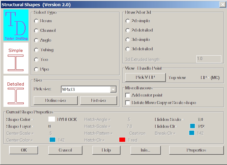

drwhite Posted February 11, 2013 Posted February 11, 2013 I have a lisp routine called Steel.lsp by Stephen R. Taylor I purchased some years back, around 2000 or so. It creates 2D and 3D Autocad drawings of structural shapes. It may be in the public domain by now, I haven't found it recently. May be at Cadalyst. Screenshot: Quote

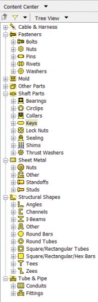

RBPrice Posted March 1, 2013 Author Posted March 1, 2013 Reasonable commnent JD - as I have said in the past, I was fortunate to have the capability of 3D fasteners and shapes from Release 11 to 2008. New I have 2013 and do not. Yes, they were supplemental packages but they were developed by Autodesk authorized folks. And from my perspective, when I am asked to design a special manufacturing system for one of my customers, we spend some time discussing how many features should be included and how much they are going to cost. If AutoCAD 2013 can do 3D work, then Autodesk should provide an option for things like 3D fasteners and shapes for those users that want them. I do not want a flat panel display on the dashboard of my pickup truck but I do want cruise control, antilock brakes etc. becasue they make the truck safer and more functional. AND THEY ARE AVAILABLE OPTIONS And just for the sake of my curiosity, does Inventor have a complete 3D library of every Imperial/Metric fasterner and steel/aluminum/pipe shape? Quote

JD Mather Posted March 1, 2013 Posted March 1, 2013 And just for the sake of my curiosity, does Inventor have a complete 3D library of every Imperial/Metric fasterner and steel/aluminum/pipe shape? Every? Not sure about that, but there is an extensive library and anthing that isn't in the Content Center I can easily find on-line or create myself and add to the library. Seems like it would be fairly simple to build a library in AutoCAD too. How many different fasteners structural shapes do you use. It is common to try to reduce standard component variety. My biggest problem in Inventor is too much stuff. Once I find what I need I move to a custom library so that I don't have to wade through all the stuff I don't normally use. In addition to the Content Center there are also a number of Design Accelerators that build common components on-the-fly from specifications you enter in dialog boxes. Quote
