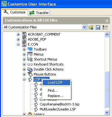

asos2000 Posted December 11, 2012 Posted December 11, 2012 There are a few reasons why I did it this way:1. I want to be able to keep my collection of lisp routines easily accessible by organizing them into individual files. 2. I want to be able to use the commands individually if needed. 3. Last but not least...I honestly don't know any better As you said you want to attach the lisps to cui. There are 2 ways - Attach to cui directly (as see in attached pic). this way used to the lisps u use too much and there is no button for this lisp - Load the lisp when click the button for this command for example this is line in macro of the button ^C^C(load "C:/Menu/Lisps/Lisp1");lisp1 be sure to replace \ with / in file path or \ with \\ Quote
