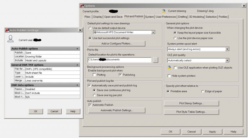

Just discovered auto publish on save and I love it, but can the filename be changed?
I output plenty of drawings that are 30+ paperspace layouts from a single 3D model, so the auto publish feature of outputting a single PDF for me is fantastic.
The one thing I would like to change/customize if possible is the output filename. For example, B250.dwg always saves as B250.pdf, which is fine, but I would like to automatically insert a date and time into the filename itself. The advantage would be saving a new PDF every time I save the .dwg rather than overwriting the same .pdf over and over.
Does anyone know if there's a way to customize this?

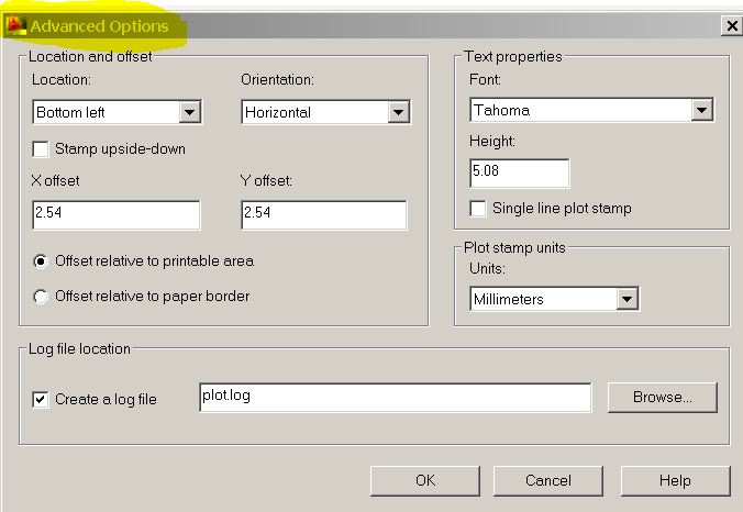

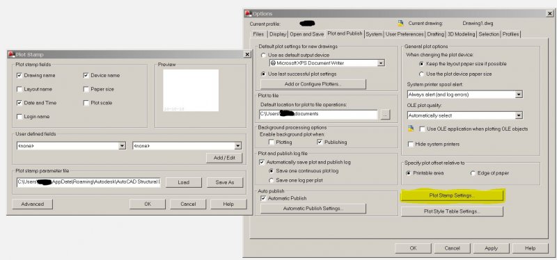

Have you considered the PLOT STAMP SETTINGS?
Yes, I know you are describing something different, but there are some other features which you might enjoy using,
like the user defined fields, which do enable some additional text.
I looked into plot stamps and found them to be extremely limited. I use MTEXT in my title blocks with fields inserted for far, far more flexibility.
