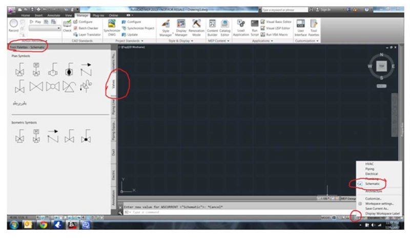

integrated-aqua Posted December 12, 2012 Author Posted December 12, 2012 Are you referring to the visual styles that allow 3D objects to be shown in different ways? I don't believe so, no. I don't know how to explain it any better than I did in my first post. I am missing a panel on the Ribbon Menu - under Manage. If you click on this image you can see what I am trying to get to - but that cannot be achieved without that Style & Display panel under Manage on the Ribbon Menu. (NOTE: this screenshot is NOT from my machine - I am trying to achieve what is displayed in this screenshot - it was sent to me by someone else.) Quote

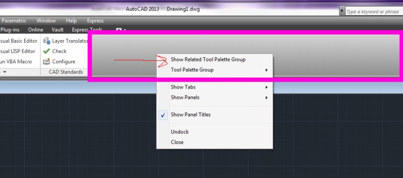

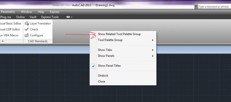

pqphillips Posted December 12, 2012 Posted December 12, 2012 Ah... the tool palettes. Right-click in the gray area of the ribbon and click "Show Related Tool Palette Group" Quote
integrated-aqua Posted December 12, 2012 Author Posted December 12, 2012 I don't have that option when I right click...just a list of options with check boxes in front of them - all are checked???? Quote
pqphillips Posted December 12, 2012 Posted December 12, 2012 I don't have that option when I right click...just a list of options with check boxes in front of them - all are checked???? Are you right clicking in the area I have highlighted? Quote

tzframpton Posted December 13, 2012 Posted December 13, 2012 You are in the default AutoCAD Profile and/or Workspace. Go to Options > Profiles and select an MEP Profile instead. *Note*: if you start the program in the vanilla AutoCAD Profile, and switch to an MEP Profile, all your catalogs and tools won't work. You must start in an MEP profile for all your MEP items to work properly. *EDIT* You'll know if you're not in one of the MEP profiles by simply typing the command line version of the tool: STYLEMANAGER or DISPLAYMANAGER. If it returns an unknown command then that's exactly what the problem is. *EDIT #2* Thanks SLW for the catch. I'm permanently subscribed to the MEP forum so it notifies me. Quote

ReMark Posted December 17, 2012 Posted December 17, 2012 The image in post #3 looks like the OP is in AutoCAD MEP 2013. However, in post #4 the image makes it appear as though he switched (unknowingly?) to plain AutoCAD. Quote
SLW210 Posted December 17, 2012 Posted December 17, 2012 The image in post #3 looks like the OP is in AutoCAD MEP 2013. However, in post #4 the image makes it appear as though he switched (unknowingly?) to plain AutoCAD. Probably because post #3 was by the OP and post #4 was by someone else. Quote
