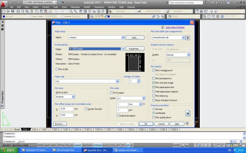

Jay Hatfield Posted December 12, 2012 Posted December 12, 2012 After designing a simple 3d model, I can only get it to print right with 2d wireframe. Unfortunately, I don't want all the lines showing up, just the ones on top. I tried all the views, but only 2d wireframe works. Need lines, not concept or realistic shades. Thanks Quote
Jay Hatfield Posted December 12, 2012 Author Posted December 12, 2012 I've tried everything and a 3d model looks fine in paper space and model space, but will only plot without jagged lines if it's in "2D wireframe" I need it to print right without jagged lines and not show all the lines underneath for "3D view". Why does it look fine until i do a print preview and/or plot??? Quote

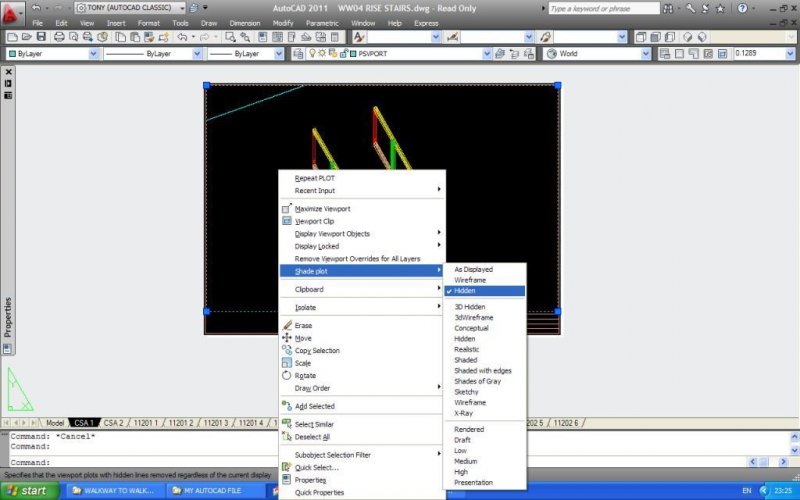

resullins Posted December 12, 2012 Posted December 12, 2012 Select the viewport, right click, go to "Shade Plot," use "Hidden." Don't use 3D Hidden. Try that and see if it works. Quote
Jay Hatfield Posted December 12, 2012 Author Posted December 12, 2012 No, still doesn't work... I just discovered that the lines aren't jagged when i plot them though, just in preview. When I plot them they are very faint and hardly even visbile. WTH??? Quote
tonyj Posted December 12, 2012 Posted December 12, 2012 Try this. Firstly set your model in 2d wireframe and then set your ploter to what I have shown in the 'plot' image, then right click your view port and select what I have shown in the 'plot 2' image. Make sure you select hidden on the top part of the fly-out and not the one lower down. Let us know if this works. Quote
Jay Hatfield Posted December 13, 2012 Author Posted December 13, 2012 Thanks TonyJ! That works great! That was really starting to annoy me. Resullin, did you mean post image of file...can you post dwg files here, just see image and links. Quote
