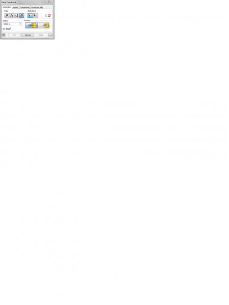

You should still be able to use insert, just give an offset distance and choose opposed or aligned for a solution. Pic from 2013:
If 2009 doesn't let you do that, you might be able to make the two centerlines concentric. Just use the regular mate command (with mate instead of flush for solution) and select the two centerlines.
You have always been able to add an offset to Insert.
And you have always been able to mate two cylindrical faces (will find the axis of each). A second Mate constraint would be needed for offset distance.
