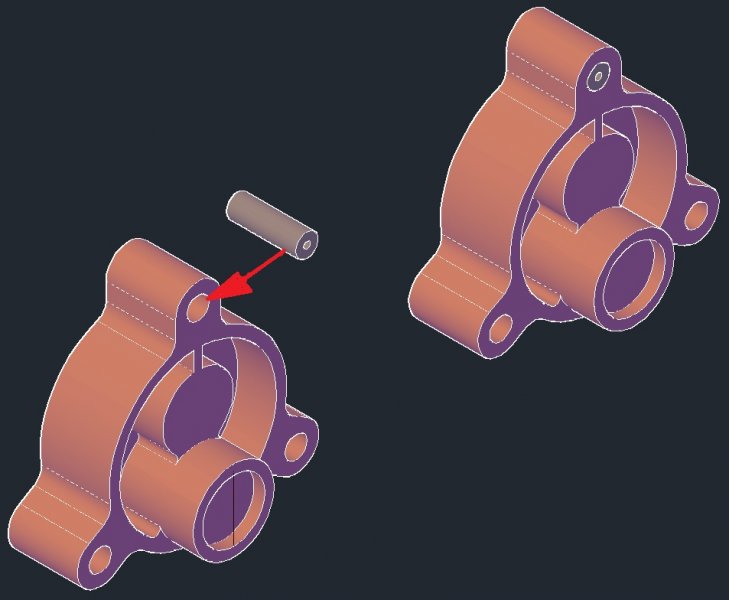

Since your part is now a single solid item, the easiest way to do what you are after is to draw a cylinder, internal diameter eqaul to new hole diameter, external dimeter equal or bigger than existing hole diamter.
Then place it in the hole and use union.

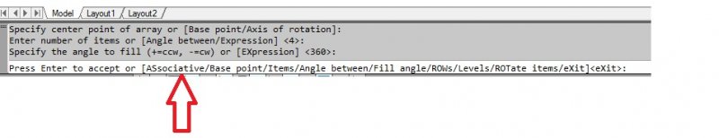

as for your other question, if you follow the command line, after specifying the angle, you have the choice of haveing associative or non-associative

OK Hoss - that had occured to me after I posted the question but it is such a clugey way to solve the problem. It seems to me that ACAD 2013 ought to have a better way to handle this - like select the hole and change the diameter. And I know that probably can be done in Inventor but I'm not working in Inventor.

When using Delete Faces it is often useful to go to wireframe shademode to make sure you select the face and not an edge line. (a cylindrical face has several lines depending on some variable that I have long forgotten - you don't want to hit one of these lines)
I tried on your part and it worked fine (when in wireframe).
Sorry, I missed where you actually wanted to change the Hole Sizes.
Solidedit>Faces>Offset
