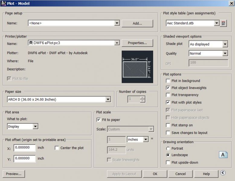

The product is AutoCAD 2013 Architecture. It installed fine. Typically, as part of the install routine, I go in to the Plot dialog and set the plot style table to monochrome.ctb.
However, on this particular install... something is different. When I open the screen, typcially the plot style table is set to 'none' and I then set it to monochrome.ctb. That is not the case on this one. It is defaulting to AEC Standard.stb and monochrome is not in the list.
I read elsewhere to run CONVERTPSTYLES at the command line. I tried that and it did work..however it does not hold the setting. If I close and restart CAD, I am right back to the AEC Standard.stb default again.
This seems to just be a problem with new drawings? If I open one from the network, it does have the monochrome.ctb setting already set.
I assumed it must have been a problem with the default in options, but I believe I have it set correctly? See below.
If I interpret the above correctly, the plot style table drop down box should be defaulting to 'none' ? but it does not... it defaults to AEC Standard.stb.

AutoCAD Architecture starts with a predefined template.Your file from your server is also a predefined template.
Template files contain predefined settings, and can include plot style table settings.

The plot method (CTB or STB) is set at drawing level. I believe that your issue is due to the template file you are using. Please check what you have selected when start a new drawing - command NEW.
Check this out probably change last line entry to your server dwg
CONFIG
FILES
Template settings
Drawing File Location
