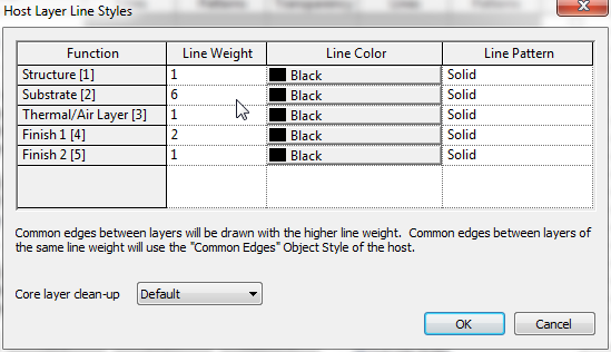

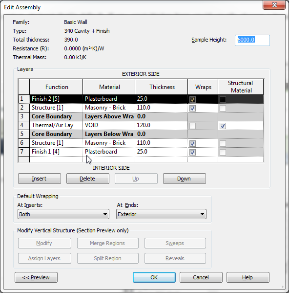

If you mean you need to differentiate the different layers of the wall, then you need to turn on the Cut Line Styles in the VG dialog. E.g. here's a cavity brickwork wall with plaster finish to both sides:
The way I've enabled this is to turn on the Cut Line Styles:

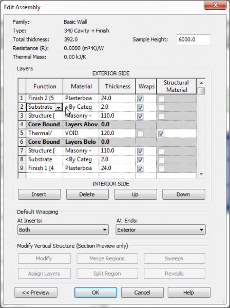

And then add different line weights to each Function of the wall layer:
Of course the wall's cavity should actually have thinner lines, but unfortunately common edged take on the "thickest function's" line weight. There's a work-around though:
