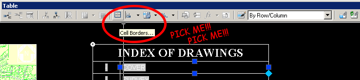

I created a table and the boss wants the cells and frame lines turned off. I can't seem to find a way to do it, or if it's even possible. If not, does anyone know of a lisp to remove them?
Absolutely. You do it very similarly to the way you would in Excel. Look for the button on the table toolbar that has a square on it and the tooltip says "cell borders".
Click the one to the right in the dialog and it will shade them back. They will display on screen, but not print.
Cool! I didn't notice the snake on my screen! Thanks!
