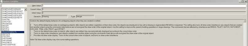

Probably not as simple as this, but since it seems like the system behavior may have changed, probably a good idea to consider the DRAWORDERCTL system variable.
