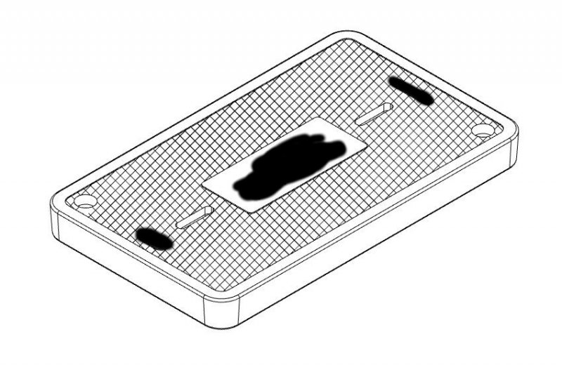

This is the result I'm getting. Yes, I can sketch on that view and project geometry, etc., but I can't seem to get it to lie on that plane. The hatching is still 45 degrees to the plane of the paper, not to the plane of the part.
The only way I can find is to hatch two times so you can control the angle for each direction to match the iso angle. Looks like IV needs to work on hatching for the next release.:)
