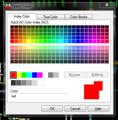

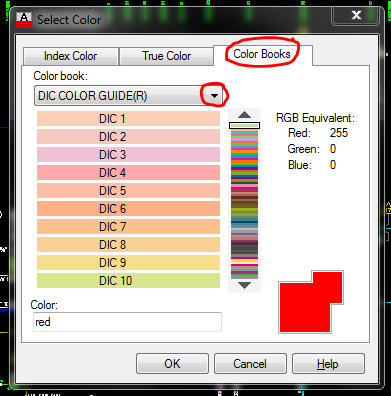

Where color is critical I would think you would use a specific Color Book designation as opposed to an Index Color or a TrueColor.
