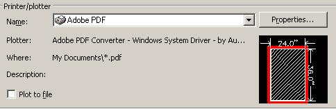

I want to print pdf. Actual pdf size is 2.27mb. But when I send it on plotter for plot it , pdf file size increase up to 46.9MB. I wait more than 60 min for plot. :(But nothing came out.
Plotter display windows shown as processing print.
Please tell me how I print it fast or how I decrease pdf size for printing.
2,27 Mb doesn't sound that big, actually. Where do you see the information that the file size has increased, in the printer information window or in explorer? Are you using the internal AutoCAD printer driver "DWG to PDF"? What printer are you using, and is the printer driver up-to-date?
I found file size increase in plotter window. Explorer show only 2.27mb. my plotter name is "HP Designjet 510 42in."
Every thing is up to date. Before any print I always plot dwg. to pdf.
I think the red borders in the view under the "Properies" button mean that the layout is not fitting into the plot area. I would try rescaling the plot to fit and see if that helps.
It doesn't matter. If I use "fit to scale" it will clear red border, but it will not help in file size or plot pdf.
