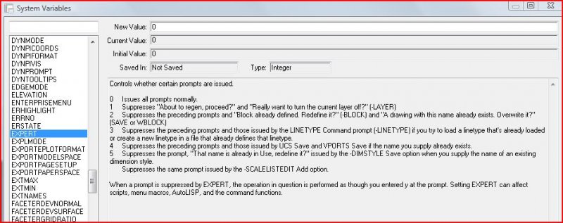

Here are the numerous different options available for the EXPERT system variable.
