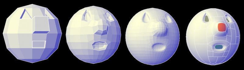

JD Mather Posted January 3, 2013 Posted January 3, 2013 OK, here is the example file. Mesh.dwg Left to right Orignal>Smooth More>Smooth more a second time>Smooth Optimized-Delobj=1>Convert to Solid Notice the final solid has several Faces - I changed the color of some faces with the Color Faces command. Quote
knattagh Posted January 3, 2013 Author Posted January 3, 2013 Thanks for the example! I am not sure what the Smooth Optimized-Delobj=1 means. What I did was the following: original>smooth more>smooth more again>Smooth Optimized > convert to solid and the last step, convert to solid, does not work. Quote

JD Mather Posted January 4, 2013 Posted January 4, 2013 I tried typing in SmoothOptimized-Delobj=1 into the command bar to no avail. I meant to type Smooth Optimized with Delobj set = 1 and then Convert to Solid. This is so that you don't have the surface body and the solid body overtop of each other. Another option would be to move one or the other to another layer and then turn off the surface layer. Quote
knattagh Posted January 4, 2013 Author Posted January 4, 2013 Oh thanks I get it now. ReMark I had it on DelObj = 3 and just changed it to 1. I'm pretty sure i followed your steps JDM. I then cut the face > pressed the shell button > selected the solid > selected the big face produced by the cut > entered some thickness > and now my screen looks like the pic I attached and I am not sure what to do. Quote
JD Mather Posted January 4, 2013 Posted January 4, 2013 Now we enter a second - more difficult phase of the problem. Imagine that you have a circle of R1mm and you try to offset (similar to thicken) towards the inside of the radius a distance of R1.1 or and distance greater than 1mm. What is the solution? In 3D the curvature of a face takes more analysis to find where a problem of this type occures. To find the problem locations it is usefull to go back to surfaces and Thicken one-by-one. The process and solutions is a bit beyond a web forum discussion. If you exapand your command line or hit F2 you should see an error message something like - could not find solution at vertex..... Quote
