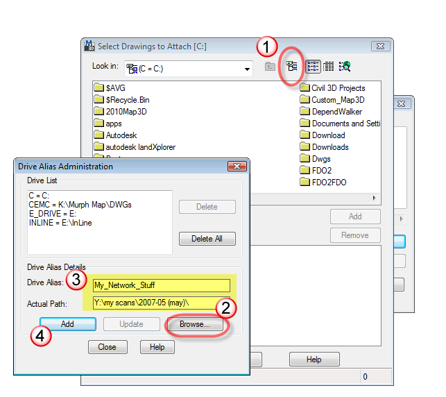

Simple with Civ3D and the Map Attach dwg then query tools. That's ADEDRAWINGS and _ADEQUERY from the command line. To make it easy if you need it alot is once you create the query save it to an external file and edit it to turn it into a lsp and put in on a toolbar/ribbon or where ever.

If you're doing surveying/land management type dwgs then that's what it, mapattach/query, was designed for. Holler back if you need help setting it up.
If you need to attach a dwg from a network path you need to create an alias for Map3D to browse to it.
