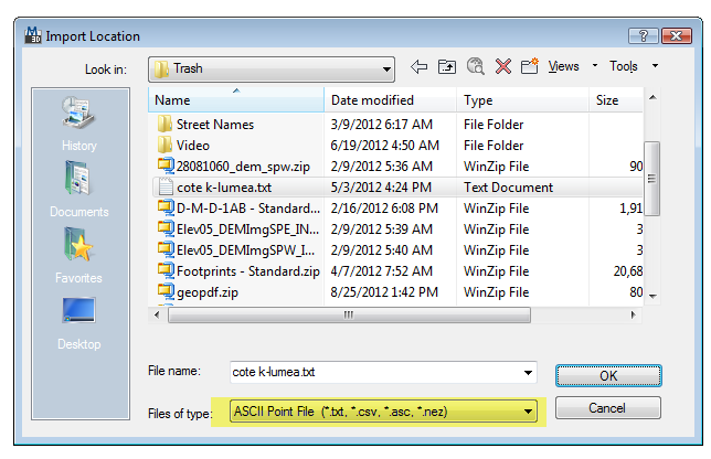

Murph_map Posted January 8, 2013 Posted January 8, 2013 Well if you are using MAP3D like your profile says then just use the Map tools amd import the text file. Quote
