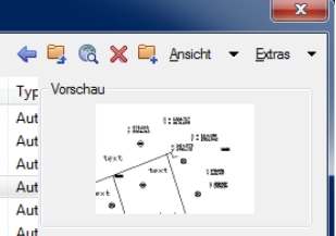

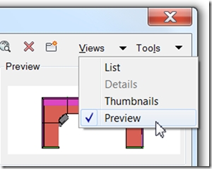

I was discussing this with a friend in the US and we noticed something strange and we are not sure of the cause. In AutoCAD 2012 when the File Open Dialog Box is displayed there is a drop down option list called Views and the option at the bottom is Preview. That's the same in both the English and German versions of AutoCAD, other than in German its called Vorschau. When the option is ticked (checked) a preview is displayed, if it is not ticked then no preview is displayed.
In AutoCAD 2013 this option for Preview does not exist because the Preview is always there.
OK, how do you see this in your version of AutoCAD 2013. Who sees the preview and who not?
Or, is there a setting somewhere that controls the visibility of the preview. I don't know, but I would like to know.

On my home system, using AutoCAD 2013, I do not have a preview of my drawing yet on my work system I do. Strange.

MSasu: Thank you for that link. I reset the hexadecimal value (in the Registry) from 0 to 1 as suggested and now I have a preview of my drawing. You da man! Thanks ever so much.
The Registry key in question is this one...
KEY_CURRENT_USER\Software\Autodesk\AutoCAD\R19.0\ACAD-B001:409\Profiles\your profile\Dialogs\Select File - PreviewVisible = 1
