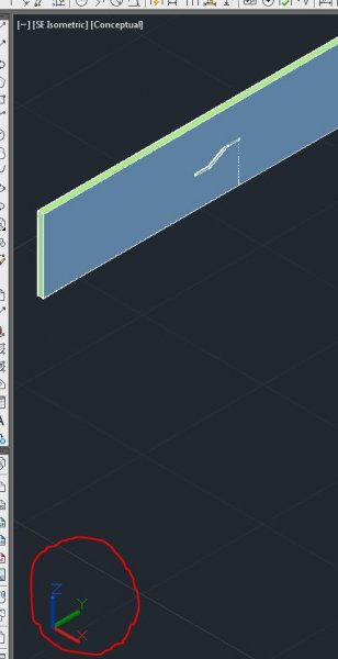

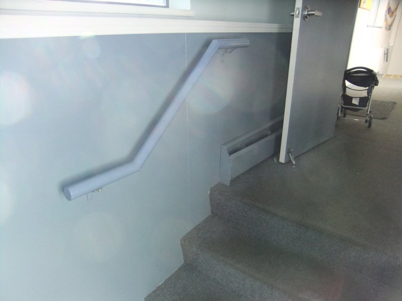

JamFam Posted January 18, 2013 Posted January 18, 2013 Hand rail.dwgGreetings all. I have tried to rotate this railing in 3D so that it looks like this photo but I can't. I've tried several different things with the UCS but clearly I don't know what I'm doing. So I'm turning to the CAD community that does. Can anyone help me? I can draw the hand rail no problem. But the drawing always leaves the finished hand rail in the X,Y plane. I need to rotate it in the Z axis (I think). Here is the orientation I want the railing to look once it's drawn. I need a step by step procedure so I can learn how to do this the correct way for future reference. Thanks Quote

Dadgad Posted January 18, 2013 Posted January 18, 2013 This is always going to be easier visualized in an isometric perspective than an orthographic view. By the way, it is already correct, if you look at the image, you will see that the ground plane is the XY plane, and that your handrail is at a higher elevation on the Z axis, at what may well be the height you were after. You don't really need to manipulate any UCS here, you just need to be able to access different VIEWS or PERSPECTIVES, so that you can see what it looks like from a different angle. I typically keep my VIEW toolbar on my desktop, and use it all the time, or I also like the VIEWPORT CONTROLS which were new in 2012 I think, you can see them in the upper left hand corner of the image. You can easily change your VIEW, VISUAL STYLE and VIEWPORT CONFIGURATION there. Quote
JamFam Posted January 18, 2013 Author Posted January 18, 2013 I know of the UCS but whenever I try to apply what my understanding of it to an object I just get confused even more. I want to be able to use the UCS because I know it can help now and in the future. It's one of those tools I don't use because I don't know how to. Sounds crazy I know. Once I "get it", like riding a bike, I'll use it more often I'm sure. From the SE Isometric view the railing "looks ok" but when I view it from the end of the wall like in a section view, I see the hand rail is flat not vertical. I think once I "get it" ( the UCS rotation thing) I won't be confused. #D rotate command?? I didn't know about that? Is there a simple step by step exercise I can practice that can help me grasp this UCS thing? Thanks everyone. Quote

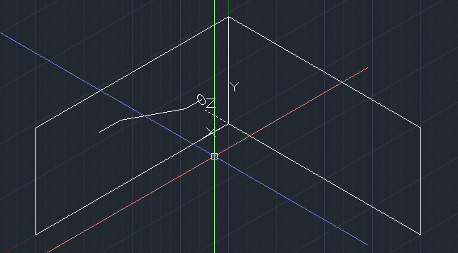

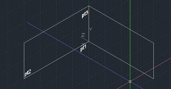

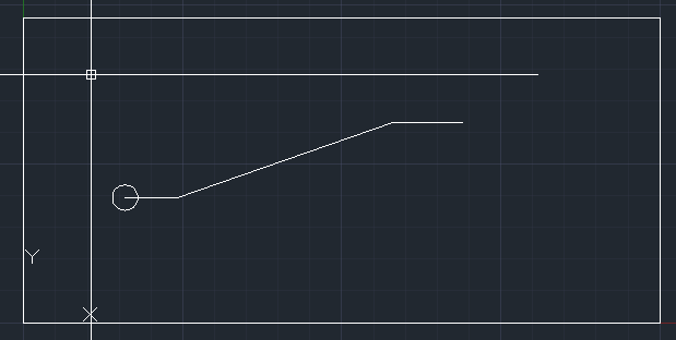

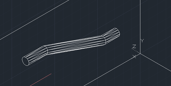

BIGAL Posted January 19, 2013 Posted January 19, 2013 A quick tutorial bit rough THICKNESS 2400 draw a line 5000 long draw a 2nd at 90 deg 5000 long Vpoint 1,1,1 you will see a wall created. OK ucs 3p pick pt1 as cnr pt2 along as new X axis pt3 vertically above cnr sets Y axis Then UCS S give it a name wall1 Then Plan you are now drawing on the wall. Draw your handrail as a pline then move pick handrail 0,0,0 0,0,100 this puts handrail 100mm of the wall add a circle for tube dia on end of handrail use rotate3d to swing the circle sq to handrail then just EXTRUDE pick circle PATH pick pline all done Quote
JamFam Posted January 19, 2013 Author Posted January 19, 2013 Thanks for all the help. What seems to work is the 3D rotate. I drew a new hand rail, once drawn, I picked the 3D rotate tool then grabbed the appropriate rotate ring and rotated it 90 degrees. What I can't figure out though is when I view the entire floor plan in layout the hand rail is not visible but the "line" that has the grips that moves the hand rail is and it's about 2 feet away from the wall. However when I look at the stairs in front view, there it is perfectly where I want it. The more I dive into 3D the more I'm developing a love hate relationship. I have another post topic I will be submitting about a section view that is incomplete. Thanks everyone. Quote
