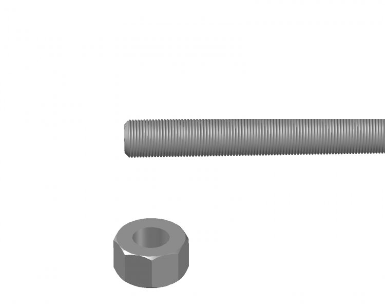

I have another question. I am working through JD Mathers tutorials and got stuck on Tutorial 4, Figure 16, adding a .75 mm chamfer. How is that added?
Also, JD's tutorials are very helpful. Thank you.
It should say something like Extrude a circle with Taper and then Intersect.
Another option would be to Revolve a triangle and Subtract.
Attach your file here of what you have attempted so far.
I like the first method myself.

JD: Here is what I have done. The tutorial says to add a chamfer to both sides of the nut. I assumed it was referring to the chamfer tool. I have a few more questions about that tutorial I would like to ask. For instance, the small triangular cutting tool...how are the details of that determined, size, position etc.

Looks like you are on the right track from what I can tell from your posted image.
Are you going to thread the nut too (not that it matters I suppose)?

I am going to finish the tutorial, so yes, I want to thread the nut. It's good practice and quite a bit more structured than the trial and error method I have grown accustomed to.

Trial and error will only get you so far. A good tutorial like JDM's really helps to get one's thought process on the right track. Follow through on it.

The information on thread forms comes from the Machinery's Handbook.
The actual cut or rolled threads might be a bit different out on the shop floor. (root and crest)
