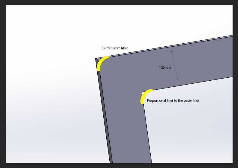

Hi,
Im trying to get a proportional fillet. Ive set the outer fillet at 6mm but what would the inner fillet be?
If i do it by eye it looks off.
Its a simple extruded object.
Many thanks in advance
Your fillet would be -114 you can not have 6 and a distance of 120 to be proportional. You can have a min fillet rad
The inner fillet should be equal to the outer fillet radius minus the distance from the outer edge to the inner edge. That's why the -114 mm answer above. If your outer fillet needs to be 6 mm, then your inner fillet just has to be big enough so there is no sharp corner. Anyway, if they are 120 mm apart nobody is going to "see" a proportion problem.
Try dividing 6mm by 120mm. .05 mm? If there is no mechanical reason for a fillet inside, I would not even bother. There is a limit to how tight a machine shop is going to cut an extrusion "gate"? "Mouth"? what is that thing they force the material through? 'pasta shape pattern'?
